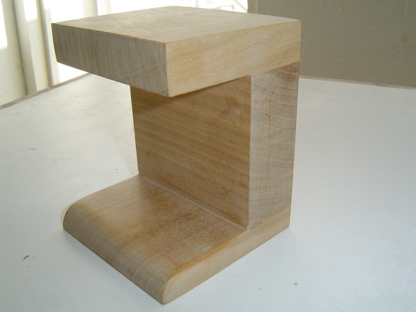

I don't know if it counts as laminated but I always use three piece headblocks. In fact I glued one on last night.    My headblocks use both a top extension to bolt the neck extension on to and a Spanish heel so I use three pieces to get the grain orientation I want. This is the partially shaped one I put on last night. Made from Cherry to match the neck.
ColinColin S38919.4592013889

Colin,
Thanks! A picture is worth 100 words. I can see exactly what you mean about the grain orientation; end grain gluing surfaces are minimized. I may use this style on the next one.
